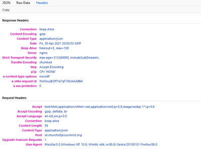

        Not sure why photos I uploaded aren't appearing.
        Anyways the first image referes to their Authorization service of Okta. It says it hit a custom error in the in the various files showing a typical stack trace,
        The second shows the JSON request from their site:
        errorCode: "E0000006"
        errorSummary: "You do not have permission to perform the requested action"
        errorLink:  "E0000006"
        errorId: "oaehinU0CiqTjORZLqnBeCd5w"
        errorCauses: []
        Third image elaborates on the headers for the request and response headers.
