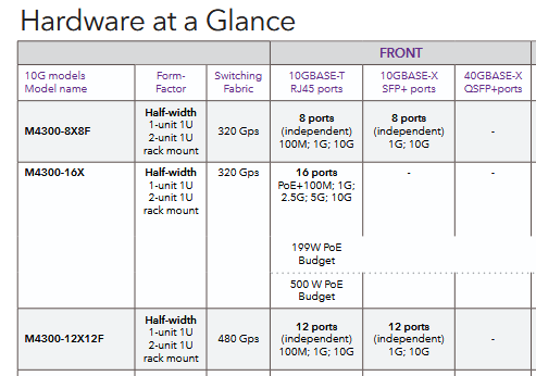

    The Product Data Sheet clearly states compatibility with both 10G and 1G SFP+ modules:

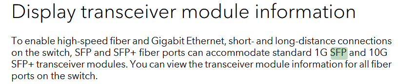

    The User Manual says the same thing:
    Internet searches seem to indicate that it should be possible to insert an SFP module into an SFP+ port and the module will operate at 1G.
