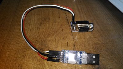

I succeeded the reset with my Arduino tools: a DE9 connector on a MAX232, a PL2303 TTL to USB, 4 dupont wires and I was done, but strange thing: TX is on TX, RX is on RX... (I'm used to the oposite on Arduino...)
As I'm on Ubuntu, I had a hard time using minicom as a CLI terminal, I finally had to install GTKTerm, after, it took me 1 minute to reset the switch, but once the reset sequence launched, I had to "manually" reboot the switch, as after half an hour, it was still with amber LED...
So mission complished, I can start to train myself with this museum piece!
