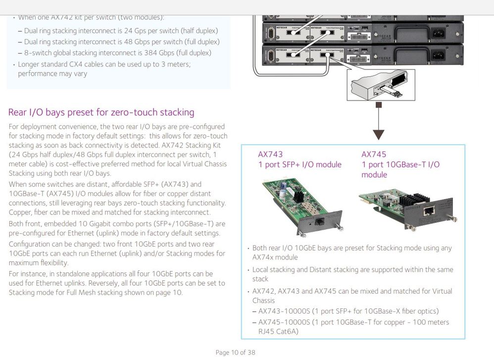

On the front of the switch, there are two shared 10G ports (port 49 and port 50) that can be each used either with copper (10GBASE-T RJ45) or with fiber (10GBASE-X SFP+).
On the back of the switch, there are two other 10G ports (port 51 and port 52) that can be available when inserting one or two 10G port modules in these rear bays.
For instance, an AX743 port module in the first rear bay will bring a port 51 being a 10GBASE-X SFP+ garage. If you want to use it for your SFP+ DAC uplink connection to another switch, you just need to configure the port 51 as an Ethernet port first (GUI, System / Stacking / Advanced / Stacking Ports) since by default, the ports 51-52 in rear bays were preset for stacking in M5300 series. The running mode will remain "stacking" after you change the configuration, it will require a reboot to see the running mode changed to "Ethernet". Then you will see a link up to our other switch using an SFP+ DAC cable.

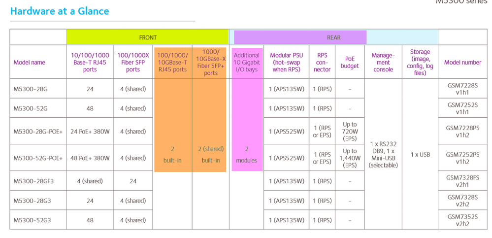

Hi Laurent,
With all due respect, that is not what your data sheet says. It is very very clear that the FRONT has 2 x Shared 10GB Ports and 2 x Dedicated 10GB Ports and the REAR has 2 x *additional* I/O Bays - see below.
Are you saying that your data sheet is incorrect and that the FRONT does NOT have 2 x Dedicated 10GB Ports and 2 x Shared 10GB Ports ?

Thank you for your question and I am sorry to see some confusion here. Maybe with the word "shared", namely here. I confirm the datasheet is correct, and you are correct too.

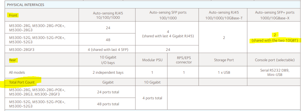

Based on this specific table in the datasheet, the two 10GBASE-X SFP+ fiber ports are shared with the two 10GBASE-T RJ45 ports. You show two combo ports, in other words, being two copper ports combo with fiber ports. It means we can use either copper or fiber at a time on each pair.
Maybe the Tech Spec section of the datasheet can help as well, it starts with Physical Interfaces and port counts:

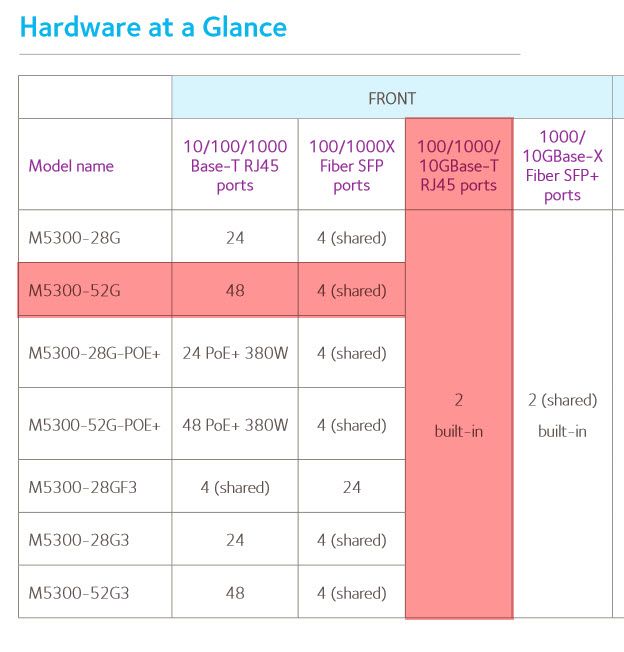

Can you please show me where it says that the RJ45 10GB Ports are "Shared"
- LaurentMaJan 25, 2019NETGEAR ExpertHi jiska78, here and like everywhere else in the datasheet, the fiber ports are shared, hence with the copper ports.
There are at least to screenshots in this thread clearly showing the SFP+ are shared with the 10GBase-T IMHO:
Front
- 2 x Auto-sensing RJ45 100/1000/10GBase-T
- 2 x Auto-sensing SFP+ ports 1000/10GBase-X (shared with the two 10GBT)

Re-thinking after a night, the "M5300-52G3 is a “48 + 4x10GbE” is correct - there are four 10GbE capable interfaces in total, two shared 10GBase-T/SFP+ (plus the two 10GbE I/O slots).
