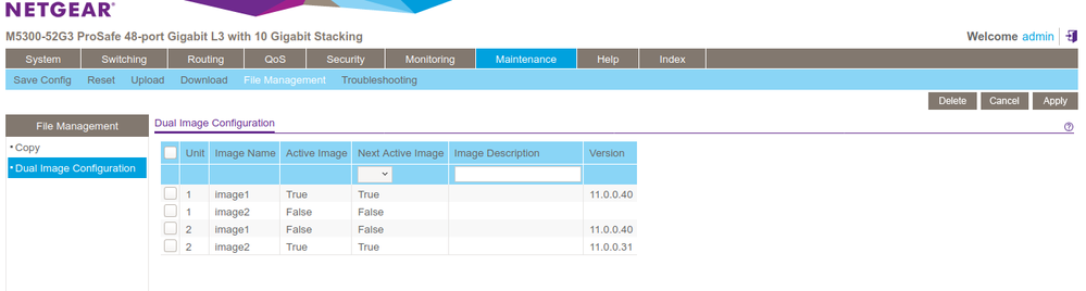

Hello,
we are trying to upgrade firmware on our 2 switch stack .
after uploading and reset power we have ' Code Mismatch'
unit 1 has 11.0.0.40
unit 2 has 11.0.0.31
Unit 2 is active.
Could we get advise to fix this issue?
thanks
Robert Fantini
i just read https://community.netgear.com/t5/Managed-Switches/M5300-stack-firmware-upgrade/m-p/1424976#M4850
and realized that both switches probably did not get a power reset. will try that tomorrow.

- robfantiniAspirant
reboot of the switch running the older code fixed the issue.
note that after fw is updated, rebooting one switch at at time works. choosing all is as far as I remember was done after the new fw was uploaded.
