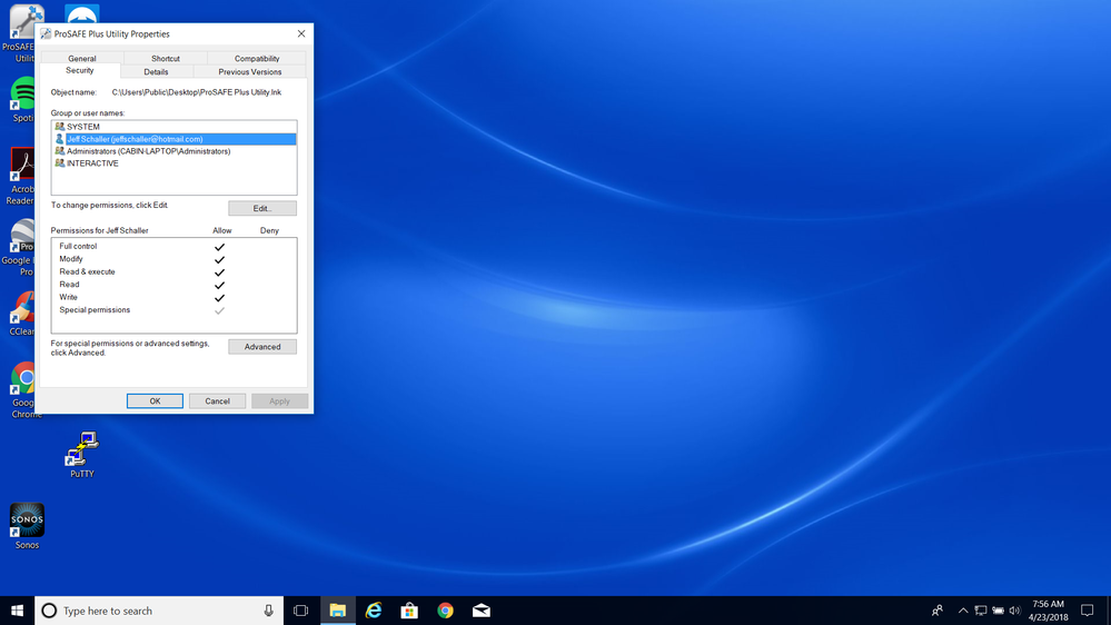

Hello,
So at this time I have changed my wired network to be "private" and tried my wifi network as both "private and public". But when I run the Pro Safe utility and attempt to apply the Firmware update I still receive the TFTP Timeout.
I also confirmed I have admin rights on the ProSafe Utility specifically. See screenshot attached. If you have any other thoughts I am all ears. :) My appt was delayed a bit so I will be online for a while longer. Thanks

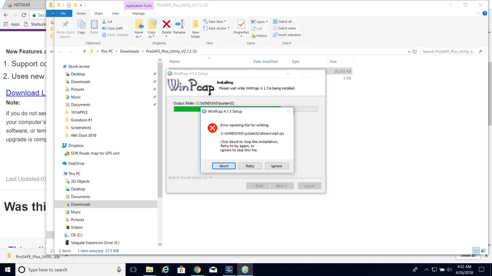

Just for a recap, I went to Netgear.com and downloaded the ProSafe Utility that it said was most current for my JGS524PE switch. The EXE is date 8/6/2010. I have been able to right click on that EXE and run it in "Run as Administrator" but I get the same TFTP Timeout.
I then decided to remove the ProSafe Utility and Download the Utility and apply it again and I got this error WinPcap error message during the install. I am hoping this is my primary issue and if we can solve for this it may begin working? I do recall getting this when I initially downloaded the utility as well.
Might this be of any help?
Just to recap: My active wired and wireless networks are set to Private, No 3rd Party Virus protection is loaded on the PC, I have run the Utility from Files Explorer as "Run as Adminstrator".

- CabinhavenApr 26, 2018Aspirant
Hi, I wanted to let you know that I was able to delete Win PCAP from my system and allow the Prosafe Utility Apply again and it did so without error this time. Sorry to say I still get the TFTP Timeout when it a run as admistrator.
