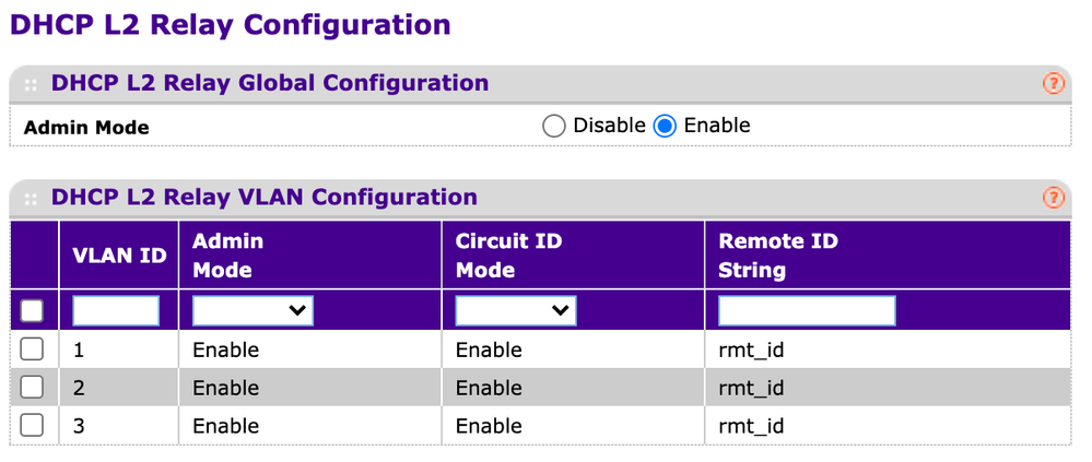

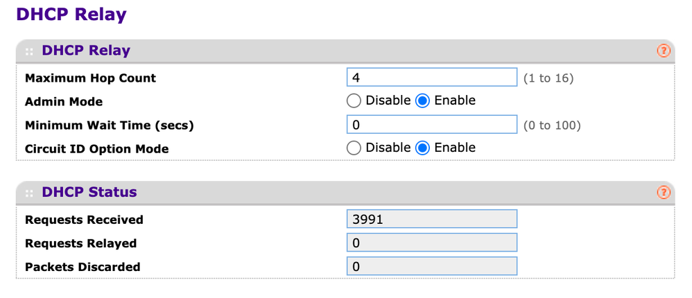

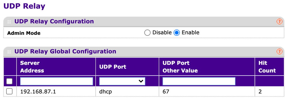

Here are some some screenshots from the M4100.
From what I understand, this should be the address of my DHCP server, the RAX40.
It looks like the M4100 is receiving DHCP requests, but it is not relaying them.
Do I need Circuit ID Option Mode enabled if I want all DHCP requests to go to the RAX40?
Does enabling DHCP L2 Relay here turn it 'on' for the entire VLAN?
Does Circuit ID Mode need to be enabled?
Why does the procedure ask me to enter 'rmt_id' under Remote ID String?
If the Global Configuration is enabled for the VLAN, do I need to enable it on each of the ports as well?
Do I need 82 Option Trust Mode enabled?

    Regarding enabling it on the ports as well: No, if you got it enabled on the VLAN there is no need to enable it on individual ports.
    Regarding routing: For every VLAN you want the switch to do DHCP relaying you also need an IP address assigned on the switch. Without an IP address the switch is not able to communicate with the DHCP clients on the individual VLANs.
