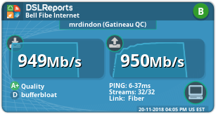

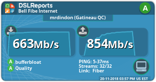

With that setup in place, I dont get speeds as good as with the gpon ont provided by the isp (http://www.dslreports.com/speedtest) :
My isp is providing 1gbps up / 1gbps down. I could test it and confirm those speeds using the ont they provided when testing it  :
Now the speed tests are done from the vm appliance (not any lan ports so I don't think the issue comes from the vlan1 portion.) my vm is having plenty of ressources and is running with around 1% cpu load - ram.

I know that ethernet might be my limitation but has you see, with the device they provide, I can get 950mbps up/down steady. (tested using their device with a workstation connected on the ethernet lan ports of it...)
