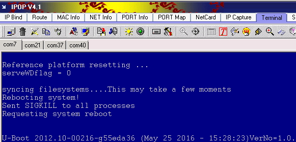

- TechAtAnimalJun 29, 2017Aspirant
Well, I managed to get a response in the boot logging window however it shows a random pattern of "B"'s for about a minute and then goes onto infinite "0"'s. I've included pictures of how it looks.
