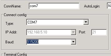

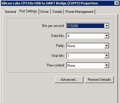

Agree with TCan’s suggestion, it sounds like your console configuration is wrong. I only add two pictures to introduce that how to change it.
Due to I cannot see your pictures clearly, so e.g. if use the ipop.exe to check logging, PC port is COM7, please change configuration as below:
Not pay attention to ip addr.
PC change port settings:
