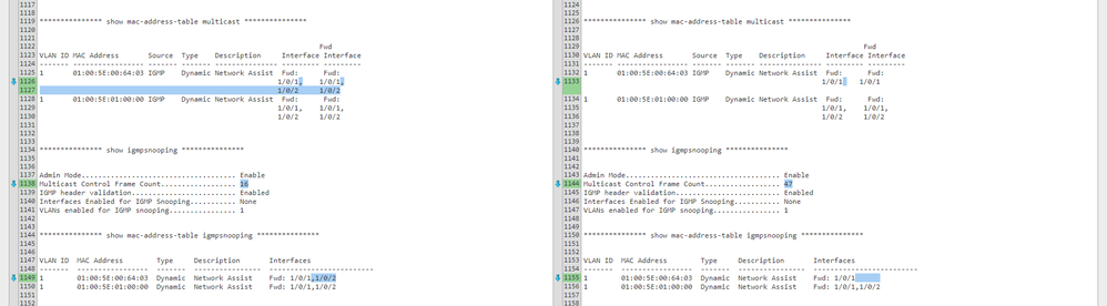

I have opened case #40496719 with support regarding this issue. For those interested I have done a basic test of both firmware versions (12.0.4.9 & 12.0.7.7)
1) boot switch using firmware to test
2) erase startup-config
3) reboot switch
4) increase MTU on interfaces 1/0/1 & 1/0/2 where my multicast devices are attached
5) check MFDB
On the 12.0.7.7 firmware my multicast receiver does not join the group. On 12.0.4.9 it does.
