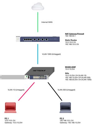

Hi there, I've been trying to setup a M4300-8X8F with inter-vlan routing for hours now to no avail. I'm running the latest firmware (12.0.4.8) and have followed all the instructions found in the U...

It's kinda hard to tell where the IP addresses are assigned. I'm guessing that 192.168.50.254 is assigned to the M4300? If yes, then are the static routes for the VLAN subnets pointing to 192.168.50.254?

Hi logicallysynced,
Welcome to the community!
Could you please do more test as below for further analysis:1. From Firewall, check if ping 10.0.10.254/192.168.10.254 success?
2. Run CLI command 'show ip interface brief' on switch
3. Run CLI command 'show ip route' on switch
4. It's better if you can provide the tech-support file of the switch

NETGEAR employee - logicallysyncedMay 07, 2018Tutor
Ah this was the problem, the default gateway was set to the VLAN SVI and not the gateway VLAN's SVI. Thanks so much!!
