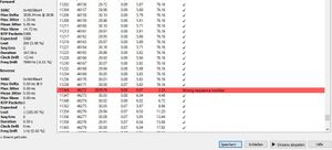

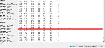

M4300/S3300 VoIP Traffic Loss
 Hello,     we heave some critical problems with our new Netgear Switches with QoS. Our network is designed as "spine-leaf". We have two stacked M4300 as Core- and 20 S3300 as Access-Switches. Some Ac...
