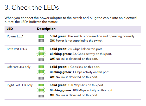

    Switch power adapter connected and plugged?
    LEDs on the switch checked? 5-port Multi-Gigabit 2.5G Ethernet Unmanaged Switch MS305 Installation Guide
    The uplink to the router LAN port as well as each device connected (and powered):
    Both port LEDs for a 2.5GbE link, left port LED only for a 1 GbE link, right port LED only for a Fast Ethernet link.
    This is it. Merry Xmas!

      The LEDs on the switch are OK:
      • Power LED: solid green.
      • Both port LEDs: either solid green (2.5 Gbps link on this port) or blinking green (2.5 Gbps activity on this port).
      • Other ports: either left or right LEDs and either solid green or blinking green (activity of older computers and devices).
