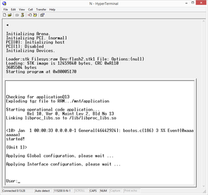

I have no password for a switch I've just been assigned to manage. Factory default of admin with no password doesn't work. I need to recover the password for this switch. The procedure I found...
- Jan 16, 2018
I found that I needed to set HyperTerminal for Flow Control "None" instead of the default of "Hardware".

Thanks! Yes, I was able to set a password and reset the switch to defaults.
I had overlooked the Flow Control specification in the procedure I referenced. The specified XON/XOFF may be correct, but Hardware Flow Control (default for HyperTerminal) does not work.
