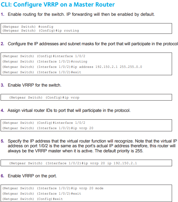

    It seems that you only configured the VRRP on the VLAN interface whose members are port 23 and 24. You can actually configure VRRP on either the interface VLAN / Port (e.g. 1/0/1). In order for you to see the port itself on the VRRP tracking. You need to configure the port for VRRP.
    Here is the reference manual (page 160).

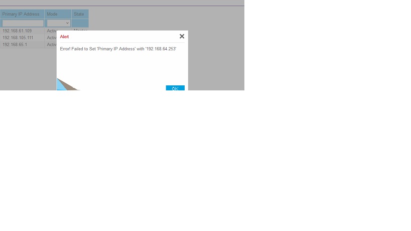

      I have tried your solution using the web interface, because I am not able to get CLI access right now.
      Unfortunately I got error when I have tried to use the interface instead of vlan when the vrrp is created.
