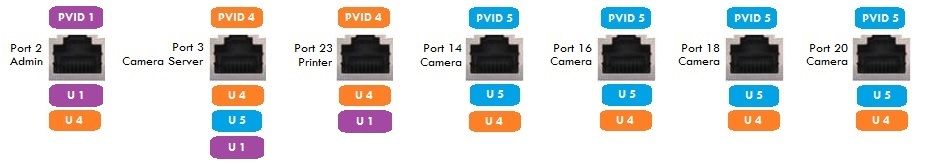

    @Quantumn,
    Here is how it should be configured as shown in the image below provided that all devices are within the same subnet:
    About port 3 where the camera server is connected on VLAN 4, it should be set as untagged (U) with PVID 4.  It should also be set as untagged (U) on VLAN 5 to have communication to the cameras connected to ports 14, 16, 18 and 20.
    For ports 14, 16, 18 and 20, it should be set as untagged (U) with PVID = 5.  These ports should also be set as untagged (U) on VLAN 4 in order for the camera server to have access to the cameras.
    About port 23, I did not know that it is the LAN printer.  Port 23 should be on VLAN 4, untagged (U) and PVID = 4.
    About port 2, you may set it as a member of VLAN 4 (if ever you want it in VLAN 4) set as untagged (U) with PVID = 4.
    You can use the default Voice VLAN for IP phones wherein an IP phone is detected by its OID (Object Identifier) and segment all voice traffic.
    About the default Auto-Video VLAN, you can use it applications that run multicast traffic.

      So, if the device attached to a given port does not understand VLAN tagging, you set it to U in its VLAN?
