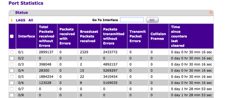

I have a M4100-26G-POE switch with several vlan trunk ports. Port 1 is the uplink and ports 3,4,5,6 are downlinks, all with same tagged vlans. The traffic forwarding looks more like a hub than a swi...

- bfowler9024May 05, 2016Aspirant
Hello Dane,
Sorry for the delay. Firmware is10.0.2.13. I have attached a diagram and traffic graphs. You will see that the traffic coming in from the uplink port 26 is replicated out ports 3,4,5,6 much like a hub rather than a switch.
- DaneAMay 08, 2016NETGEAR Employee Retired
Hi bfowler9024,
It seems that you did port mirroring. So far there are no issues logged using firmware v10.0.2.13 just like what you have described here. Can you try to downgrade the firmware to v10.0.2.11 then check if same problem will occur. Make sure to reset the M4100-26G-POE switch back to factory default settings after a successfully downgrading the firmware then reconfigure it from scratch.

- bfowler9024May 08, 2016Aspirant
Port mirroring is not configured:
