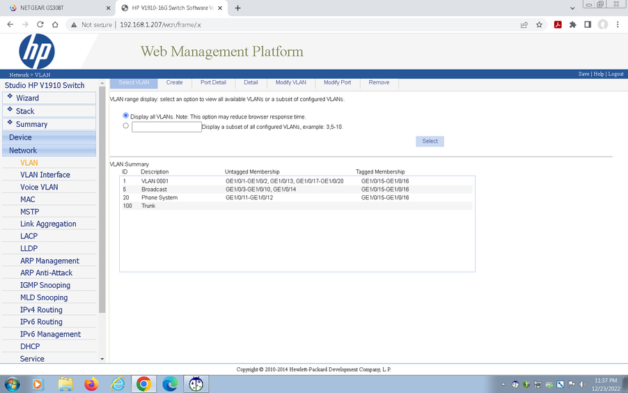

Ok Here you go ---- the Netgear:
And the Procurve:
Note that Port 8 on the Netgear is cabled to Port 15 of the Procurve.
Also note that I have tried establishing PVID 100 on the Netgear as it is in the Procurve. The picture provided shows PVID 1 on the Netgear but as I said I have attempted this using PVID 100 with no success.
Hope that helps.
-JB
- schumakuDec 23, 2022Guru - Experienced UserAlso show the VLAN Port config where the details are visible if it's [T]agged [U]ntagged on the Port level.
It's not about guessing if it's VLAN 1 or VLAN 100 you need a plan what you want to configure ob the switch (VLAN numbers) and what you need in the port. Don't be confused about th different vebdor defaults.- bakerjlb3Dec 23, 2022Aspirant
So here is more detail as to the Vlan configuration on the Procurve. I do not need access to VLAN 20 on the Netgear switch.
The other note that may help, there are other Procurve switches, with similar configurations, passing all the the VLANs via port 16 of this switch
Hope that helps. Thanks for looking at this.

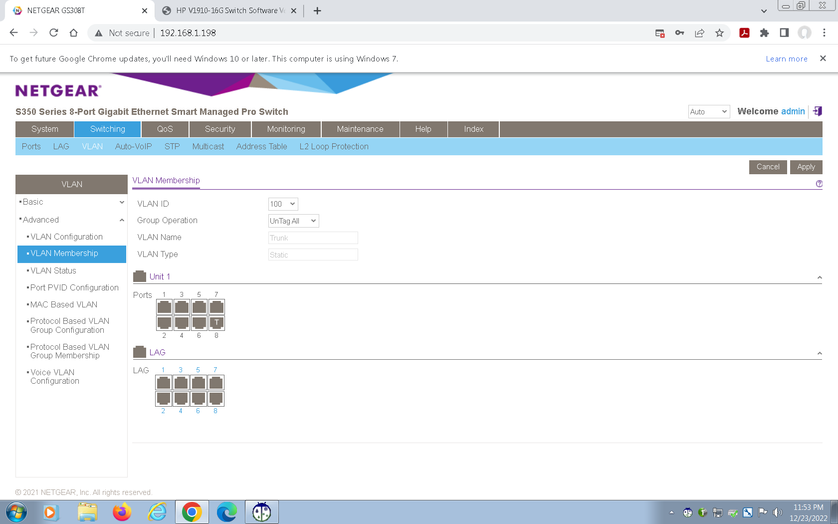

VLAN 1 Configs for the Netgear
And VLAN 5
And Vlan 100
