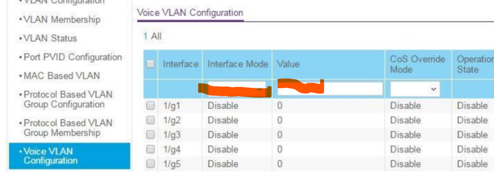

We are looking to isolate our VoIP traffic to its own VLAN. For a number of reasons, we'd like this to happen without needing to configure each phone. It looks like Netgear switches support this. ...

Hello davidcts
Have no recent practical experience with that S3300 switch series.
What looks right to me is that the Auto-VoIP VLAN is set to the VLAN ID 88.
But then, strange is that the VLAN 88 does show up as a VLAN-Type: Static
and
the VLAN-Membership for VLAN 88 is set manually to [U]ntagged
and
the Voice-VLAN-Configuration does show Operational State: Disabled
This makes me believe you have -manually- defined the VLAN 88 on top of the Voice-VLAN, manually assigning port 1/g-1 ... 1/g-52 (you don't have to do this in my understanding!) on top of what should be part of the Voice-VLAN-Config automatically once enabled.
So, remove the VLAN 88 port assignments -and- the manually define VLAN 88.
- davidctsApr 30, 2025Aspirant
I removed the manually created VLAN 88 from Switching > VLAN > Advanced > VLAN Configuration, which automatically removed any options for it from VLAN Membership.
However, I do not see any way to set the Operational State to Enabled, as displayed under Switching > VLAN > Advanced > Voice VLAN Configuration. When checking Switching > Auto-VoIP > Protocol-based > Port Settings, all ports show Auto VoIP Mode as Enabled.
Something still isn't correct; the phones aren't being pushed over to VLAN 88.
- schumakuMay 01, 2025Guru - Experienced User
Auto-VoIP Global Admin Mode enabled?
Voice-VLAN Interface(s) Interface Mode set to VLAN-ID, and the Value set to 88?
