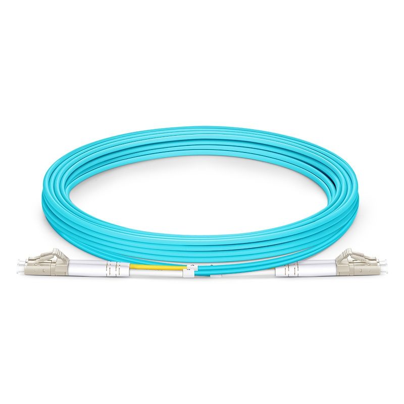

So if I needed and LC-LC fiber cable for example, would that just always be 2 core due to the connector on the end?

The more common designation for simple fiber patch cables (to carry the light in both directions) is simply a duplex cable as used on SFP small modules.

That's great, thanks for that, I've got a short one like that for testing, but wasn't sure if there was anything else spec wise I needed for a longer distance to maintain network speeds.
