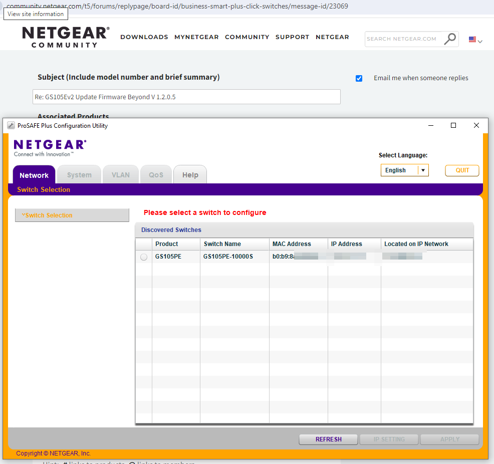

        When starting the ProSAFE Plus Configuration Utility, with the driver installed, the switch(es) will be listed as shown before-

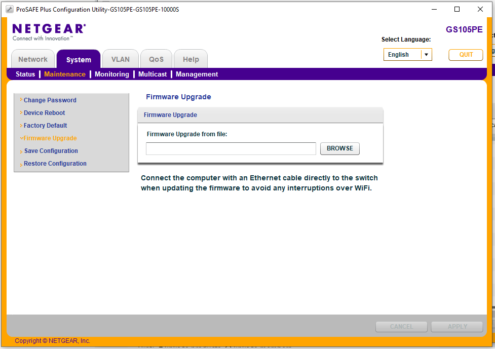

        Select the switch on the list, and click [Apply], then enter the password (or the default password).
        Once succeeded, you get this additional System .> Maintenance -> Firmware Upgrade for uploading the firmware file. Under the hood, this happens by tftp - but you don't have to worry about this.
