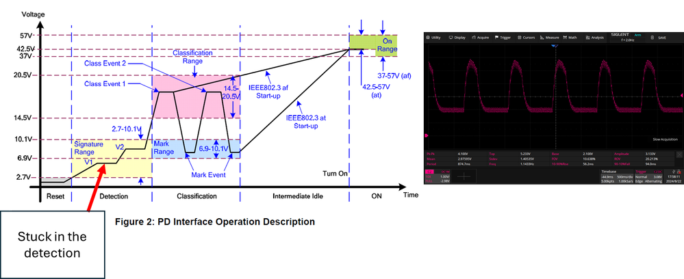

We are a IIoT device manufacturer, our gateway is PoE Class 1. One of the customer has GS108LP but couldn't power the device.
Just bought the same GS108LP and test it. I found that the GS108LP never complete the detection phase and move forward to the classification phase. I did the measurement on the output of the rectifier circuit of the PoE using oscilliscope.
The voltage is oscillating between 2-5.9V as see in the picture below.
The device already installed with lots of customers and they use the PoE with other vendors normally.
Our device spec: consumption ~ 1W, voltage 37-57. It follows the PoE standard IEEE802.3at. It uses the MP8007 PoE controller. The same reference design is used.
Any idea why this switch don't support this standard device procedure?

    Something you might contact NG support about.
    Check a different model GS series switch that has PoE support to compare results.
    Ensure any FW on the switch, if available, is up to date.
