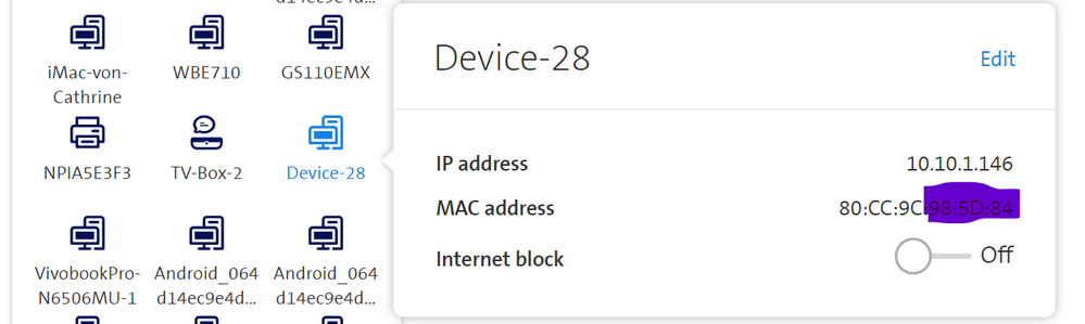

      Why ever, the GS308E does not come with any (actual) discovery option anymore. There is no other way than checking the router for the "connected devices"where the DHCP assigned IP address will become visible. The designation varies widely between todays many more or less decent routers  or cable modem-routers.
      Here on my Swisscom router, it's with the "Expert Mode Settings" enabled, under "Manage network settings" -> "Assign static IP addresses automatically"
      Your Internet-Box can always assign the same static IP address to the devices selected by you. This is particularly useful for servers that always have to be accessed with the same address in the home network.
      No idea why ISP and router makers try to reinvent magic and imagination instead of sticking with the industry standard designations...
      Yes, it's extremely difficult to find (without trial-and-error) the GS308E in that list, look here - it's identified as Device-28 why ever:
