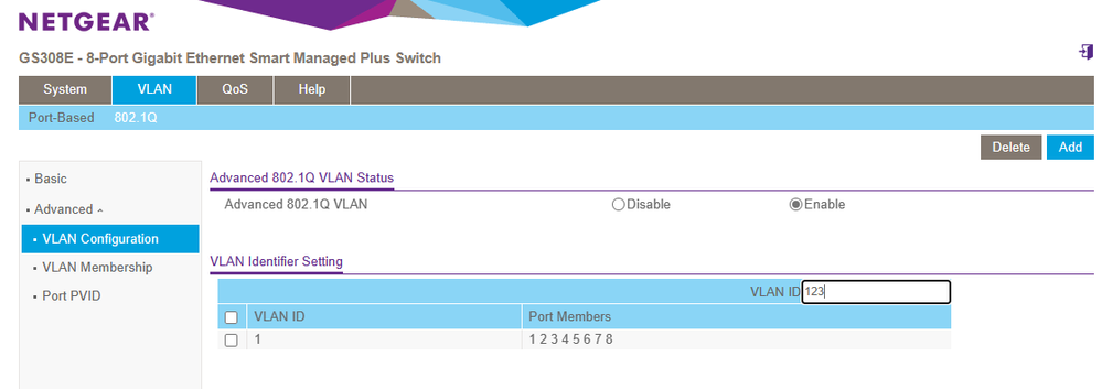

    Have just an example of adding the VLAN 123 on a GS308E in Advanced 802.1q Mode - it's very similar in the other modes and models.
    1. Head to the VLAN Configuration (here Advanced 802.1q mode):
    Type the VLAN number to add in the VLAN ID input text field, then click [Add]

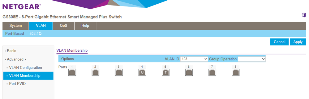

    2. Head to the VLAN Membership
    Select the VLAN just added, then you can assign the membership by clicking the port mode.

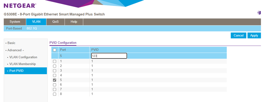

    3. Last but not least, don't forget to define the PVID
    Select the ports to define the PVID, type the VLAN ID, and use [Add]

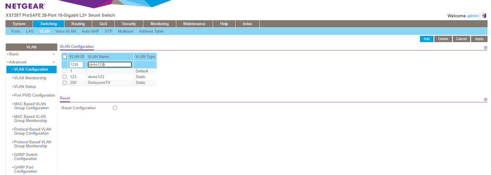

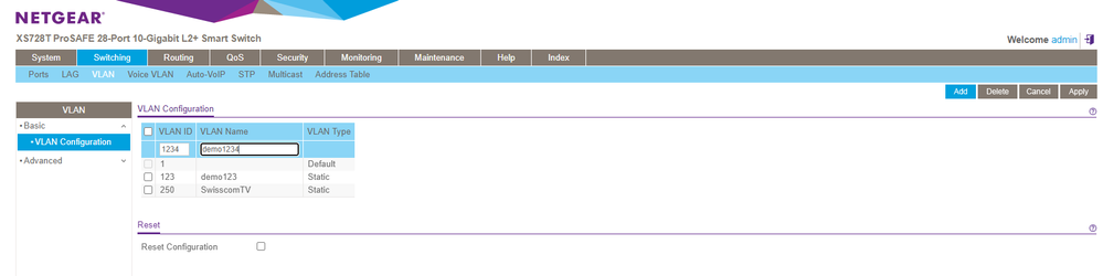

      Sorry for my confusion, it should not make any difference on the GS308T, both VLAN and name should be add-able, in both Basic and Advanced view:
