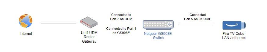

Here's a network diagram. VLAN tags are set on my gateway Unifi UDR. There's a VLAN tag 20 for IoT. Devices connected to the UDR via WiFI work correctly with VLAN tagging. But the ethernet ones don't.

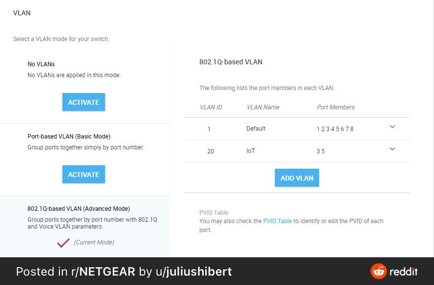

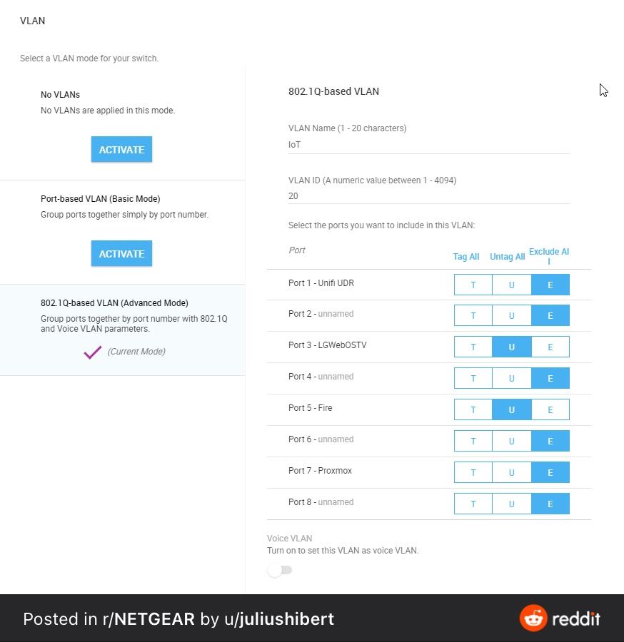

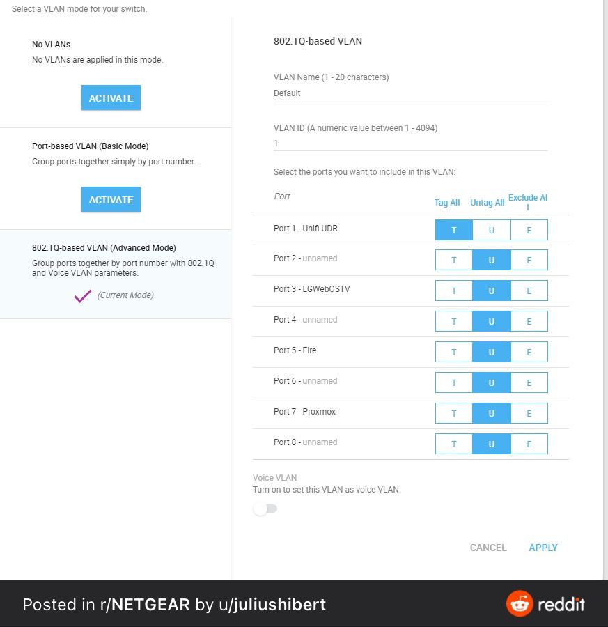

Here's how the VLANs are set on the Netgear switch.
What am I doing wrong? The IP of the FireTV always defaults to the 192.168.0.0/24 range and not 192.168.20.0/24 range (IoT VLAN).

    Why oh why you changed all 1..8 to be tagged? It's only the trunk where you carry multiple VLANs which is all tagged (or one VLAN runs untagged).
    1. VLAN ID 1:
      1. Tagged → Ports 1 .. under the assumption the VLAN 1 is delivered as tagged. This is the de-facto standard for trunk links carrying multiple VLANs. It could be also used untagged for VLAN 1 with the PVID set to 1.
      2. Untagged as access ports → 2, 4, 6, 7, 8 with PVID set to 1
      3. Exclude → Ports 3, 5
    2. VLAN ID 20: IoT
      1. Tagged → Ports 1 ... this will be your uplink carrying the trunk of VLAN 1 and VLAN 20?
      2. Untagged → Ports 3, 5 with PVID set to 20 ...
      3. Exclude → Ports 1, 2, 4, 6, 7, 8
    In general, I tent to suggest some "logical" port organization. Port 1 VLAN Trunk uplink, port 2...6 access ports for standard LAN 1, port 7, 8 access ports for IoT.

    What is the intention having port 3 and 5 untagged to VLAN 20?
    1. What is handling the IoT VLAN, how is this VLAN 20 data and IP subnet? The uneducated reader does guess it's your UDM. However, it appears the uplink to the UTM is excluded for the VLAN 20 ... where I would expect it's provided tagged. Otherwise your VLAN 20 and it's 192.168.20.0/24 subnet does never come to your FireTV (or the other TV).
    2. If untagged frames coming in on port 3 and 5 needs to go the IoT VLAN 20, so don't forget to define the PVID for these two ports for the VLAN ID 20.
    3. Why are port 3 and 5 also configured to Untagged and VLAN 1? A mess is predictable my friend. This is where your 192.168.0.0/24 DHCP is leaking in. Set these two ports where you intend to connect your IoT devices access ports to not participating neither the VLAN 1 nor any other (except of the IoT VLAN 20) port.

      1. UDM is managing the IoT VLAN and all other VLANs for that matter.
        1. It’s doing Gateway / Router / VLAN tag and network management and DHCP for all VLANs.
        2. UDM (LAN Port 2) is connected to Negear switch (LAN Port 1)
        1. VLAN ID 1:
        2. VLAN ID 20: IoT
