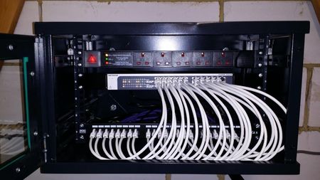

JGS52Ev2 ProSafe Managed Switch - Unable to Access via Configuration Utility or Web Browser
I purchased my JGS52Ev2 ProSafe Gigabit managed switch in August 2014 but, thanks to the fun and games of building extension & refurbishment, I didn’t actually get around to setting it up till Novemb...

    JGS524Ev2 ....2.0.0.23 is the very first firmware available for this device. Plenty of updates since. Update to the current firmware first, as of writing, this is JGS524PE / JGS524Ev2 Firmware Version 2.6.0.24 - the first thing I would to after a successful update is to do a factory reset.
    Review the Downloads Section - and enable the Show Previous Versions - for Release Notes probably requiring special actions.
    You might have to re-install the old ProSafe Plus Configuration Utility to make this update happen (worth a try anyway - this might be the problem with the utility access....) - not sure if the new one can be used because along with JGS524PE/JGS524Ev2 Firmware Version 2.0.1.40 the authentication mechanism was updated and the old utility don't work anymore. Not sure if the new utility can work with the old firmware with just the old authentication scheme.
