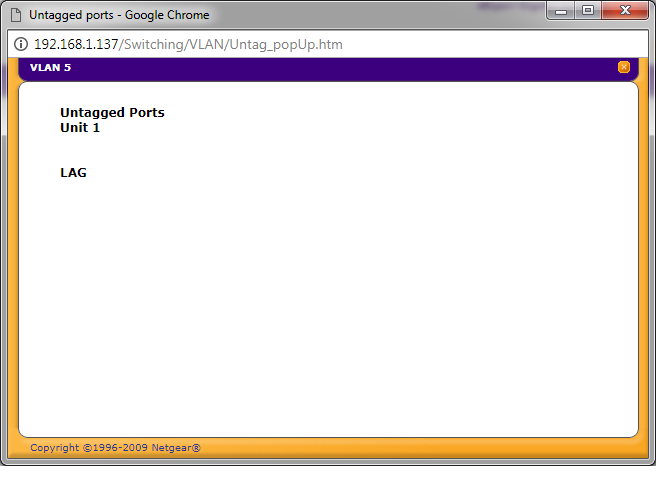

I have reset the configurations of the netgear switch but the problem still exits, I have read this configurations before in the article links you mentioned but still don't see how to assign multiple VLAN IDs to a port in a Port-Vlan ID's configurations in the switch.
I have attached to you below a picture of the empty units that are found for tagged or untagged ports...this prevents me from assigning VLANs to the switch ports.

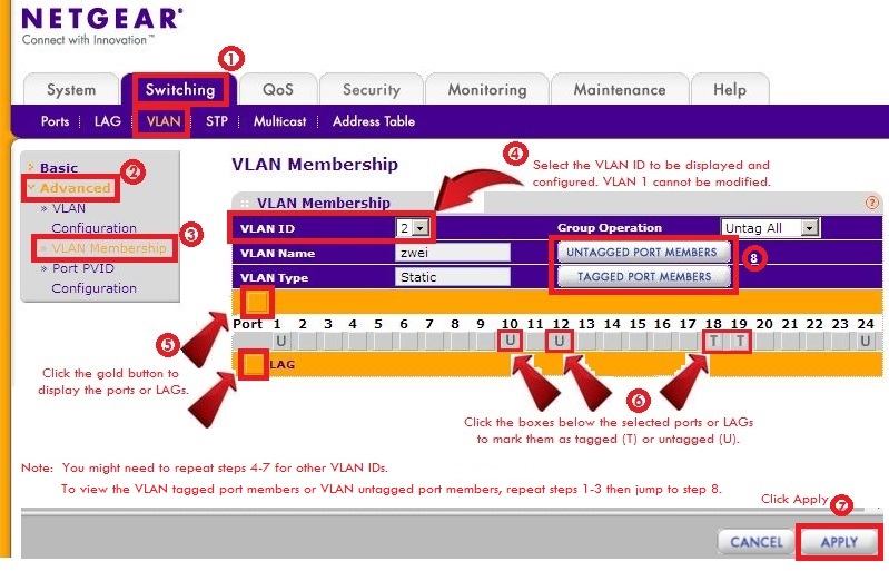

Thanks for the feedback. The image you have provided is not the page where to assign a port(s) to VLAN ID. Just want to verify, were you able to set the ports as untagged (U) or tagged (T) to the corresponding VLANs?
Kindly refer to the image below and follow the steps. Read the notes indicated as well.
As reference above, kindly read pages 4-18 to 4-20 of the GS748TPS user manual here on how to set up VLAN membership and set the port(s) as tagged or untagged.
Also, if ever the configuration screen does not display correctly, try to update the version of the browser you are using.
