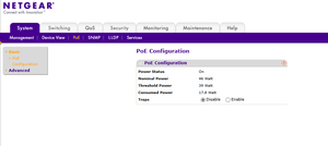

NETGEAR GS110TP-200EUS ProSAFE 8-Port switch probable fault one port
Hi I have had this managed switch for many years. Now it is used to supply POE for a number of CCTV cameras only. The typical power usage.... can be seen above. The software / firmwa...

Albeit written in Java, that failed to work and was not address in the previous model due to security (?) issues with the old version used, it was great to have a pictorial representation of the ports, connections and power etc.
You also would get information on the total threshold power, and then the power used overall in watts.
So far I can't see a way to show the cumulative power used by the latest model across all ports. Just a way to gather information myself of the wattage used on each port and then need to add these together.
