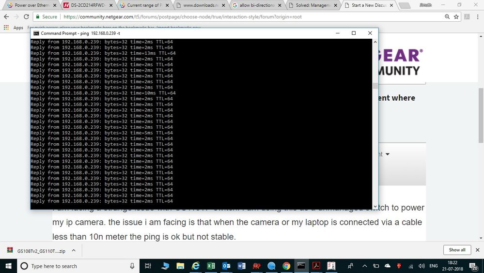

I am facing a strange issue with GS110TP switch. I am using this as a unmanaged switch to power my ip camera. the issue i am facing is that when the camera or my laptop is connected via a cable less than 10n meter the ping is ok but not stable. see attached pic
the longer the distance rto comes. Due to which my distance camera are not pinging but power is full there as they are activating ir led. and the Green LED is on in PORT,
The longer the distance the data led turns yellow and blink continously.

    Hi jimuth,
    Welcome to the community! :)
    From the screenshot posted, it seems that it is normal.  If ever the time goes beyond 100ms frequently and it increases as well, then there might be an issue.

    4. Disconnect the GS110TP switch from the existing network.  Connect one (1) camera and a laptop directly to the GS110TP switch.  Then, set a static IP address on both IP camera and laptop.  On your laptop, do a continuous ping to the static IP address of the IP camera.  Does same problem occur?  Post a screenshot of it.
