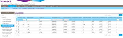

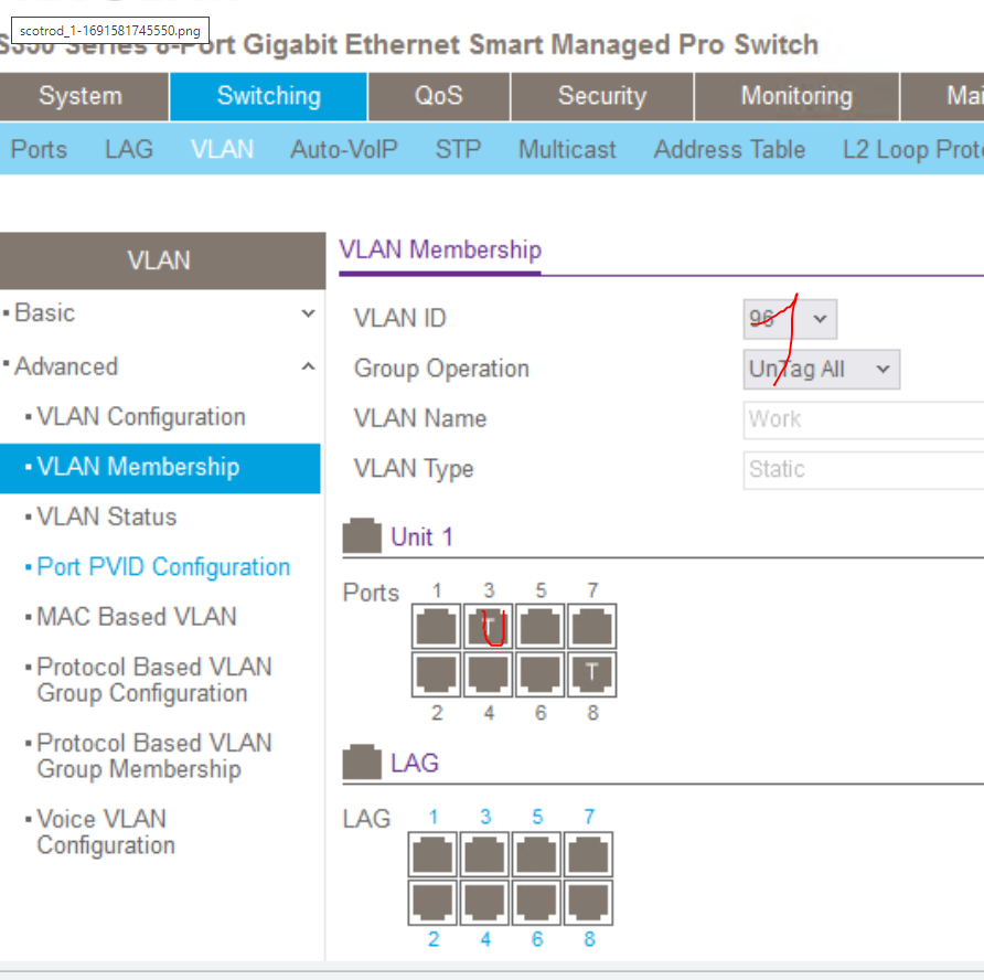

Here is a screenshot of the Port PVID config menu:
What is weird to me is that the VLAN Tag is set to None (defaults...), and currently it works like fine. The device which is connected to port 3 is in the 96 VLAN and has no issues.

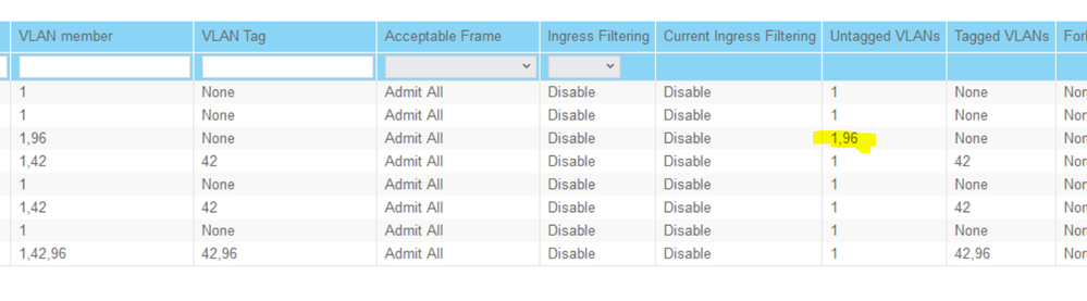

This port #3 does show up as untagged for VLAN 1,96 - why ever this is in place, it's wrong. Only the 96 must be untagged, not the VLAN 1. Your traffic does leak over VLAN 1.

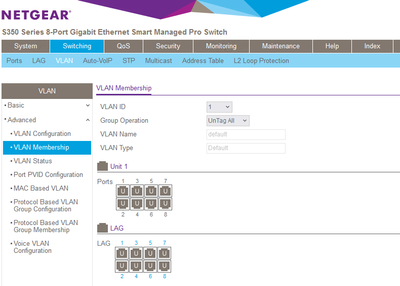

Check the VLAN Membership, select VLAN 1 ... guess you find an U for port
The Web UI should in my opinion complain about this double [U]ntagged setting (added while adding the Untagged 96?) for this port. One more beer for me from Netgear?

Correct, but I've never touched any of these:
Does this means that every time I am setting up any port, I need to go to VLAN ID 1, and remove the "U" tag from there? I guess it needs to be empty?
