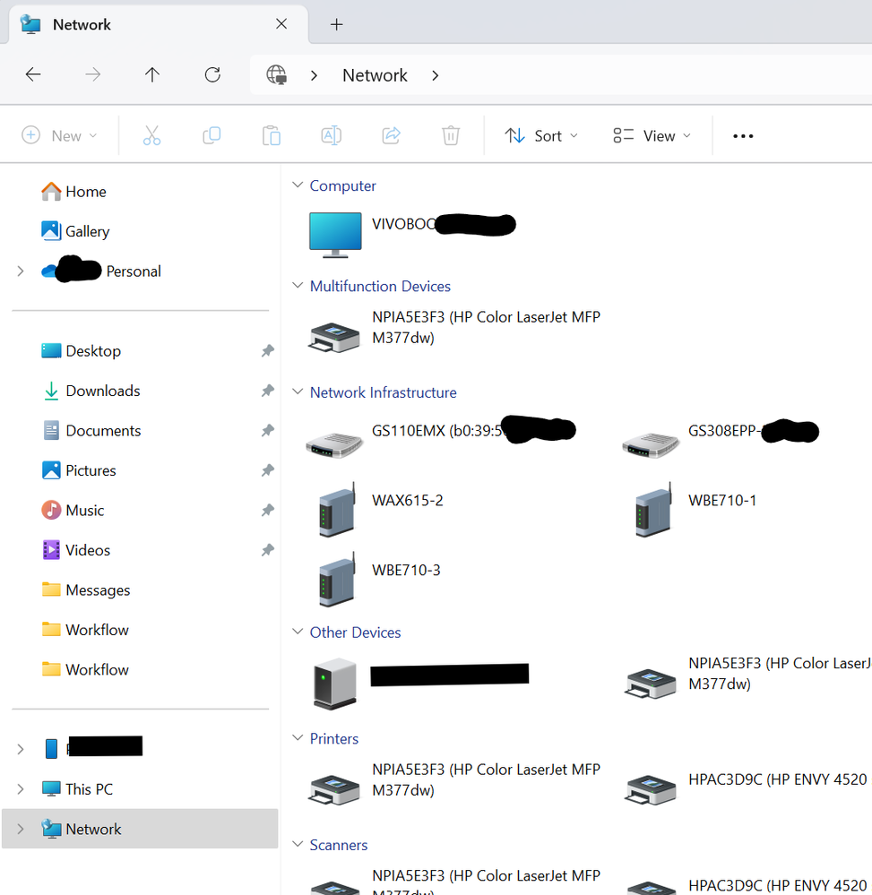

Does the Windows Explorer pick-up Computer, Network Infrastructure, Other Devices? If not, see below.

I am experiencing this issue as well. I checked all of those services, and my network settings, and I am still not getting anything to show up in the connection field.
I have another computer on our network with the same settings, and it shows an ethernet device.
