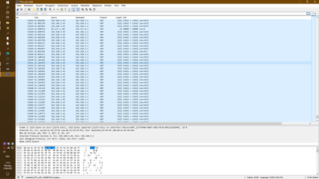

Unacceptable Frames received and switch is not forwarding frames to another port
Hello All, I am using Netgear XS708T 8 port 10GB switch( new firmware) and for that switch, I have connected one radar.( multiple in future) For port 1, radar is connected and in port 3 anot...

Yes radar is inhouse developed with MAC address AA:BB:11:22:33:55
Now I need one more help. How can I solve this issue? how can I make the switch to start working( receiving in port 1 and forwarding at port 3).

For a test, can you define the MAC address on the adapter yourself?
I'm under the assumption aa:bb:11 isn't a registered MAC OID for your devices. Play it simple, take your mobile phone, and connect it to your favorite WiFi using a random MAC (Apple names it "private WiFi address"). Slightly change it in the last bits. If it does generate a2:d7:bd:d1:7d:32, change it to a2:d7:bd:d1:7d:33 for a unique MAC different from your mobile, and try this for your device. Does the switch handle the forwarding as expected now?
From wally brain, a little bit tired after long day, can't tell this minute you what might be the effective cause.
Probably somebody from Netgear switch engineering can answer why these packets are not forwarded.
