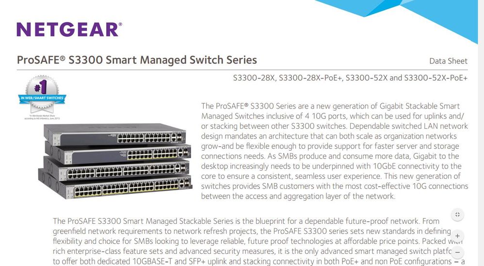

    Now we have new powerful and ease of use stackable switch S3300 series.
    We suggest you to upgrade to our new smart stackable switch S3300 series.:smileyhappy:
