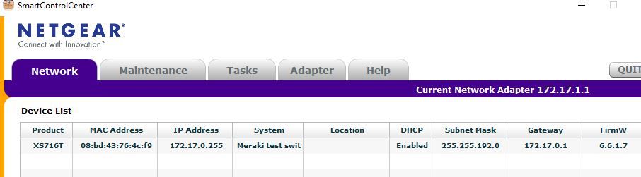

Upgrading firmware using smart control center

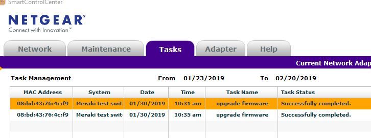

I'm trying to upgrade my XS716T from 6.6.1.7 to 6.6.3.3 following the link below.  When I go to the task bar of the smart control center, it says "Successfully completed", but when I log into the switch, I'm still showing the firmware as 6.6.1.7.  I even tried restarting the switch.
I also tried one more time to make sure.
https://kb.netgear.com/24699/How-do-I-use-the-Smart-Control-Center-to-upgrade-the-firmware-of-a-smart-switc
  • Nevermind, figured it out.  Feels silly I didn't do this, but I didn't unzip the folder.  But for some reason, the smart control center says "successful" so it it misleading.
      • JohnC_V's avatar
        JohnC_V
        NETGEAR Employee Retired
        Hi tantony,
        Thank you for sharing your solution here in our community! :) You really need to unzip the folder and upload only the firmware file in order for you to upgrade it.
