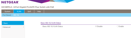

VLANs greyed out, cannot change
We have a Netgear GS108PEv3 that is installed at a remote office. It has a 802.1q configuration as follows: P1,2,6 untagged ID 10 P3,4,7,8 untagged ID 20 P5 tagged 10 and 20 I am n...

Yes, I unfortunately had to go to the site & reset the switch. As of now it is working & remotely changeable, but I have to say my confidence in the future is not high....

Just want to follow-up on this. Are you able to perform a factory reset on your GS108PEv3 switch? If yes, is it now working fine?

I'm glad that its now working fine and I understand that what you feel. Feel free to post your future concerns here in the community.
