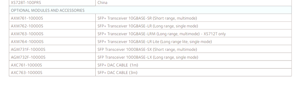

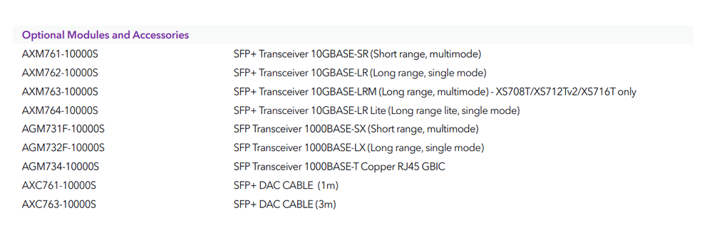

These are for example the lists of supported module types and variants on the XS712T and the XS716T:
Source: https://www.downloads.netgear.com/files/GDC/datasheet/en/XS712T-XS728T.pdf
Source: https://www.downloads.netgear.com/files/GDC/XS708T/XS708T_XS712Tv2_XS716T_XS728T_XS748T_DS.pdf
