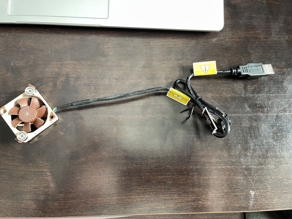

For a more non invasive solution, I went with a small fan, 2 screws and nuts, small RE magnets and a 3-5v USB power supply or any USB power supply will do. Attach to either side of the switch and push or pull air flow.
- iieeannAspirant

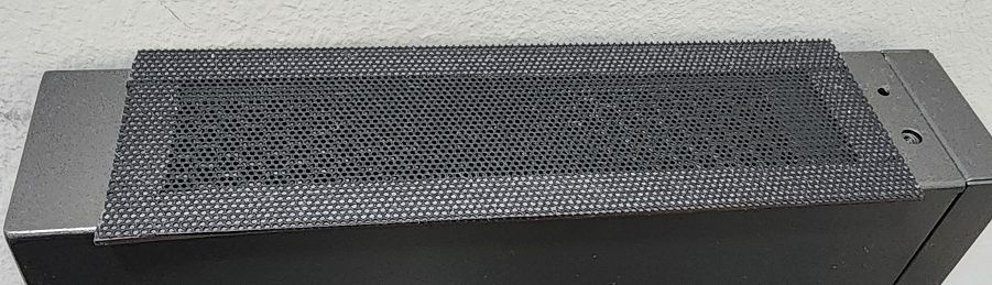

That may work with 5V fan. My fans are 12V... Speed control is important for me because the switch is at the bed room. Now the fan noise is not audible after 1.5m.
Before i modified the fans, the switch had been running fanless for almost a month, no problem at all and the casing was not hot.
The switch was put vertically, fan at the bottom pushing out the air. Air inlet side on the top is covered with magnetic dust mesh.
Duest mesh
