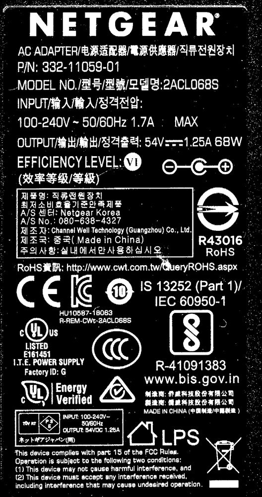

I purchased a GS108LP back in 2019.  I was never able to get it to provide POE power to a WiFi device, and getting no solution from support I just fell back to using an injector.
One symptom was that the switch's Power LED was not lit.  It has worked fine as a switch, but has never worked to provide POE.
Today I tested the power supply output and it's only 52.25v, not the full 54v expected, as shown on the label.
Would that cause this type of failure?
Here's a scan of the power supply label.

      The GS108LP was new when originally purchased, and the adapter is the one that came with the switch.
      When I purchased the switch it was intended to power a new Ubiquiti UAP-AC-LR access point.  I was never able to get that working and used the Ubiquiti-provided POE injector instead.  Netgear support chalked it up to the fact that the Ubituiti AP was an early board revision that had some known issues with some POE implementations. It has worked fine as a non-POE switch since then.
      At that time I didn't notice that the switch's Power LED was not lit.
      Is the slightly low voltage likely to cause these symptoms?
      • Switch Power LED not lit
      • Inability to provide POE
      As far as I'm aware 1.75 volts under shouldn't be a problem since POE specs have a wider range than that.
