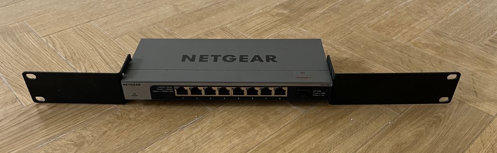

Is it possible to get OEM rack mounting ears for the GS108X?
There seems to be screw holes but I can’t find brackets anywhere. I’m not interested in the 3D printed stuff.

  • I sent an email to customer support and unfortunately got no reply. I solved this with different sized brackets for left and right. Unit is off-centre but fits ok.
    PhyinLan 4.25” (“Large”) on one side and 5.63” (“Extra Large”) on the other. Not cheap but done. Fits great.

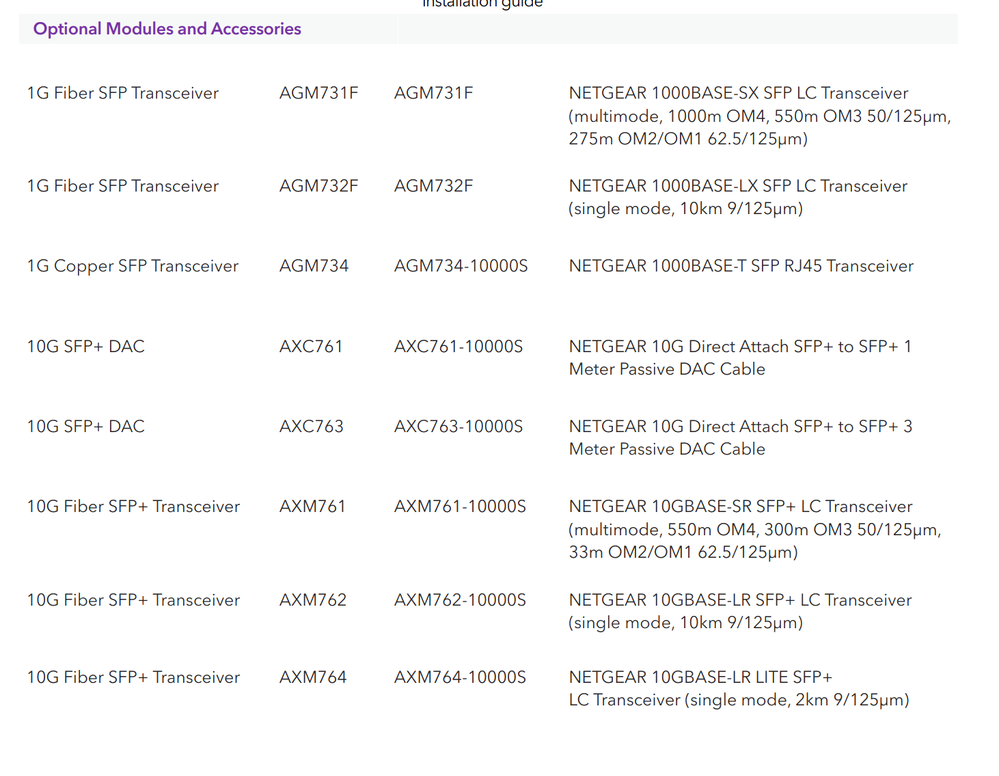

    Now, the SFP+ cable I have is only running at 1Gb. The instructions show there is a compatible 10Gb cable….mmm.

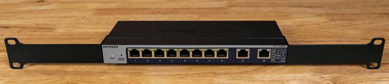

    Challenge the Netgear customer support for the rack mount kit to a GS108X/GS110MX/GS110EMX (within 1 mm the same width!) to [email protected]

    This is how the GS110EMX looked like with the rack mount "ears":
    There are no 10Gb "cables" per se. Are you referring to an SFP+ DAC, a "direct attach cable"? Due to a difference in the  encoding, connecting to 1Gb-only SFP port is not possible, due to different possible data rates:
    • SFP does support only 155M/622M/ 1.25G/2.5G/3G/4.25G data rates, as per SFF-8472.
    • SFP+ does support only 6G/8.5G/10G data rates only as per SFF-8431.
    According the GS108X data sheet, the most common module types are supported - except of the 10G Copper SFP+ Transceiver (Netgear AXM765 and AXM765v2)
    Tell us more about the SFP+ cable you try to operate (make, model, details, .... probably an "active" DAC model, apparently working on 1Gb only?

  • The old cable was an SFP+ DAC. I’ve swapped it for a Nergear AXC761 from eBay and now connects 10Gb. Sorted. Too many variables to work through specs and compatibility to work out the reason.
