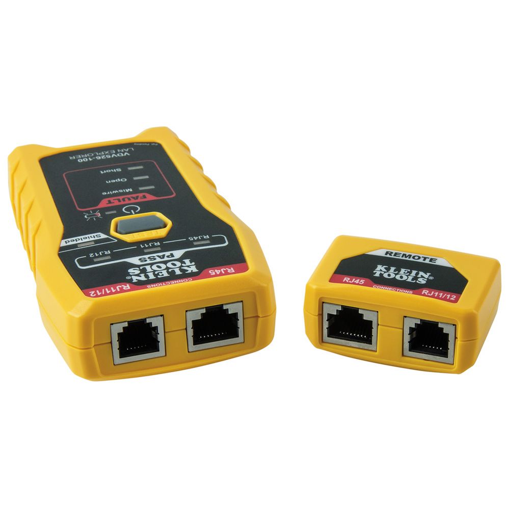

I bought a Net Gear 5 port switch so I can get internet to all four of my tvs......I have an ethernet cable running from my router in the basement to the switch in our bedroom......From there I have run four ethernet cables to each room in the house to be connected to the txs......I tested the cable from the router to switch and it passed.......I tested the cables from the switch to the tvs and they have passed......When I connect everything and power up the switch, I can not connect to the internet........So I unplug the switch and test the ethernet cables connected from the basement to the switch and then on to the tvs and it fails the test stating a short.......Does the switch have to be powered up for the cables to pass a test?......The tester warns against testing with power to the ethernet cables........I am getting very frustrated and Best Buy will not even talk to me on the phone.......Any suggestions on how I can get the tvs to recognize the ethernet.......Any help would be greatly appreciated......Thank you
Most testers come with two devices, a test head, and a remote plug. For testing, both ends must be unplugged from switch and TV. Both the remote plug and the test head must be connected to the same cable to do a proper test.
The warning is correct: Never connect and active just the test unit to a cable connected on the other end to a switch, a router, a computer, ... No useful result can be taken from the measurement. The reason that the tester show a short circuit is in the way Ethernet works: Each cable pair is terminated on a tiny transformer, similar to the design of a classic (non-switching design) low voltage adapter for chargers or electronics power supplies.

no lights are showing on the port to the TV and I can not connect to internet.....I tested all cables by unplugging the ends and connecting the remote on one side of cable and the tester on the other.......Cables all passed......The switch is brand new as well but is there an easy way to test it......I also tried installing a downloaded update that the TV recommended but that did not work......I really appreciate your reply because I am at a loss here.....Thank you.
