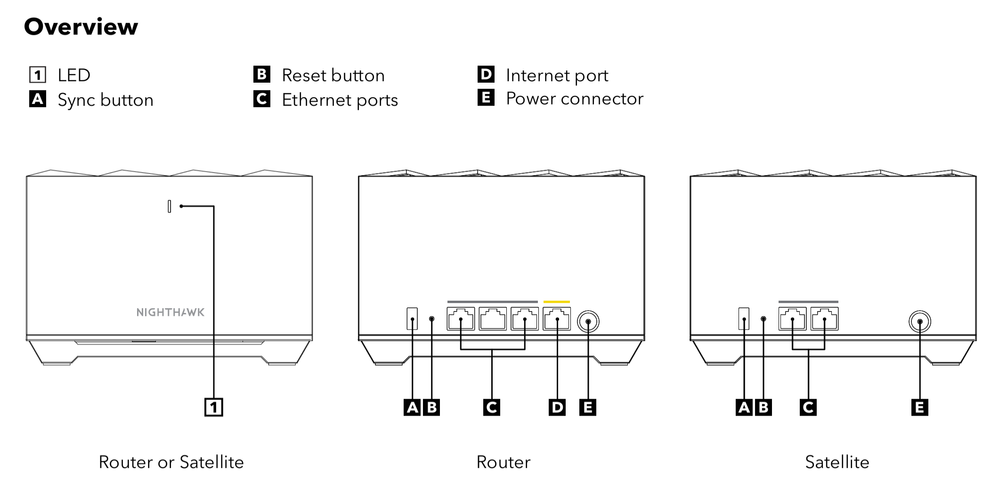

    Have only one of the MR80 (thats the router) connected to one LAN port [C] on the switch?

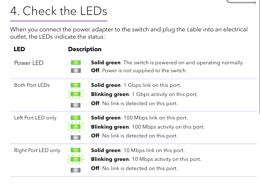

    jvarney7601 wrote:
    The Switch lights are all blinking and power is on.  When i power cycle the switch the internet does not come back, however all the ports are blinking like its sending data.
    Left and right port LEDs blinking indicate that all ports are operating on Gigbit, at a 1 Gbps link rate.
    What happens when you connect say one PC direct to one of the MR80 (or a MS80) LAN port?
    Have already cold rebooted the MR80 (the router) by disconnecting (wait some 10 seconds just in case) and reconnecting the power?
