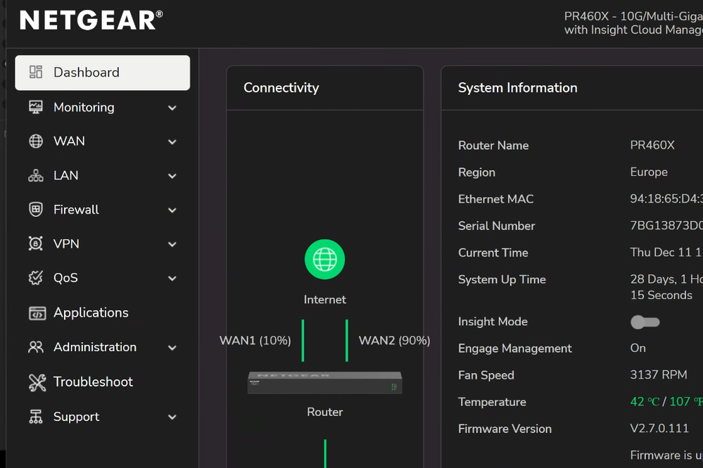

  • schumaku's avatar
    schumaku
    All my production PR60X with failover configured (and ugin DHCP on both WAN interfaces, deposit of the "static" (aka. fixed assigned public IPv4 addresses, the ISPs supplying the appropriate IP address either way here). Don't know is that has an impact (neither does using Insight, or here Netgear Engage):

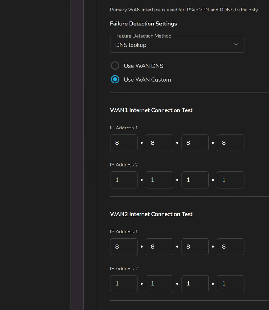

    Failure Detection Method is set to DNS lookup, using two well known DNS addresses here:

      Thanks, I have the same Failure Detection Settings. However, based on your Dashboard Connectivity diagram it looks like you have Load Balancing enabled, which I don't.
