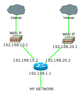

Hello, So I have a SRX5308 configured with 2 WAN for load balancing. Here's my network : I want to set up a VPN. I follow different tutorials and it doesn't work. When I open the tunned i...

Going back to the network diagram you posted, you mentioned that the two devices connected to the ISPs are switches. I believe these switches are Layer 3 switches which are connected to the WAN ports of the SRX5308. The WAN IP address that is registered on the SRX5308 are Private IP Addresses. With regard to this, I'm afraid it seems that the client-to-box VPN you want to achieve is not possible with your current network setup.

Based from the network diagram you posted, since the SRX5308 is behind another router, you will need to either open ports on the routers to allow VPN connection or connect the SRX5308 to the DMZ ports of the routers to allow VPN access.

Thank you for your answer. There is no router behind my SRX5308, it's a switch :smileywink:
