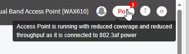

Recently updated firmware on a WAX610 to V10.5.0.16 and I am now getting the following notification:
Access Point is running with reduced coverage and reduced thoughput as it is connected to 802.3af power
This, however, is not true. It has been connected to 802.3at power since day 1.
The router as you can see is delivering at power at 30W.
And as far as enabling LLDP to force it to use LLDP, this does not work. LLDP was already enabled. The LLDP trick is mentioned here: https://community.netgear.com/t5/Business-Wireless/WAX610-802-3at-stopped-working/m-p/2109411
Is this a cosmetic issue or is there indeed an issue in the AP?

We've just released WAX610 / WAX610Y Firmware Version 10.6.0.7 which has a fix for this issue. Please try the firmware and let us know if there are any further issues.
Bug Fixes:
Fixes an issue where the AP starts operating on 802.3af power even when powered by an 802.3at or 802.3bt switch.
