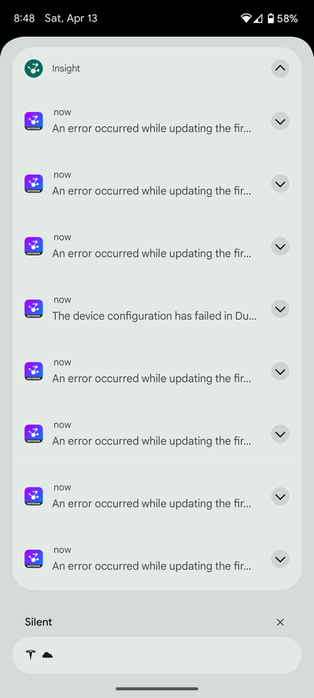

Anyone else wake up to a dozen failed firmware update emails/alerts for the WAX620s?
I have three WAX620 APs deployed in my home. V10.8.5.7 firmware on all of them. I do not pay the fee to get the app-based service, I manually update the firmware on all of them. I woke up this morning to 12 emails and 12 app alerts, three per AP, all saying the same vague thing. Why exactly would devices that I control and need do manual firmware updates on be pushed a firmware update that failed? This is somewhat concerning to me as I didn't see any communications from Netgear about an emergency firmware they were pushing out to all APs or the like.
Failure Reason: An error occurred while updating the firmware.
Failure Reason: The device configuration has failed

- RennaDNETGEAR Moderator
If you received the notifications last April 13th around 7:15AM PST to 8:50AM PST then this is expected. On that day, engineering have applied changes through Insight which would help stabilize APs running on latest firmware. As a result you may have received the notification "The device configuration has failed." and in some cases, "Failure Reason: An error occurred while updating the firmware." Some APs, which has ran into low memory, would have rebooted.

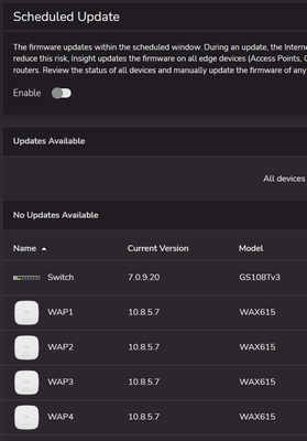

Hello jasondunn,
What was applied was not a firmware update, but rather an enhancement to APs that are on latest firmware which your APs are on (V10.8.5.7). Are your WAX620 set to Insight Management mode? Can you check if Schedule Firmware Update is enabled on the Insight Portal?

NETGEAR Team- RipTWDTutor
Mine were not set to automatically update

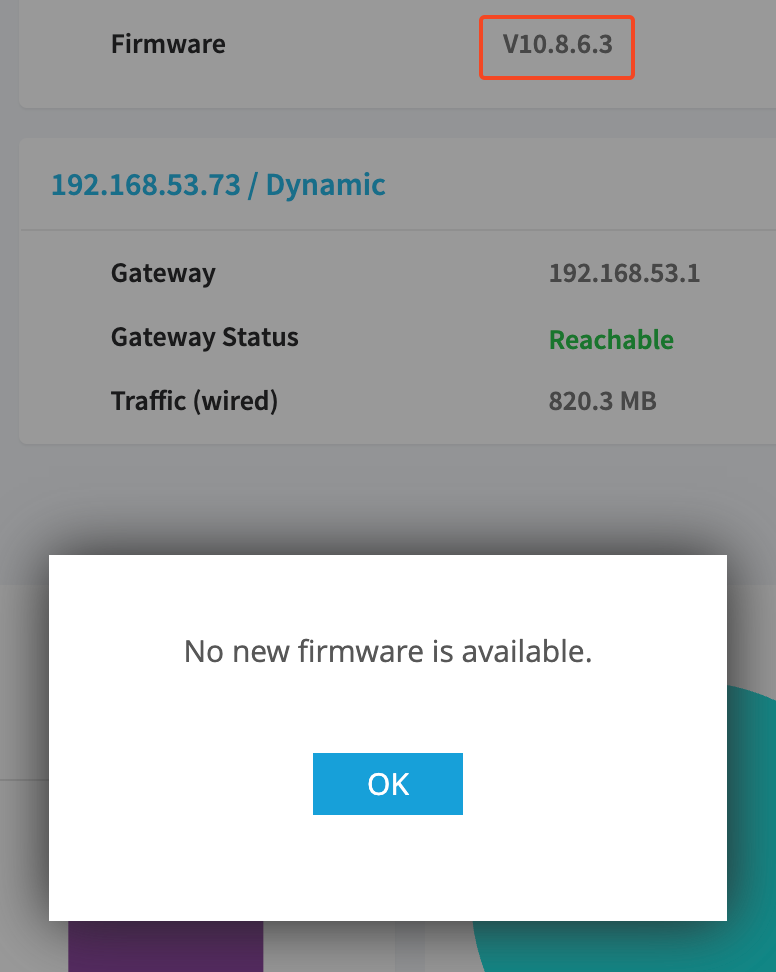

- jasondunnApprentice
Ok, this is clear now. Yes I updated all three APs myself with the 10.8.5.7 firmware a couple of weeks ago. What’s not clear is why I received an email this morning telling me that 10.8.6.3 is available but when I log into my AP running 10.8.5.7 and force a firmware check it says there’s no new firmware available. 🫤
Do the emails go out before the firmware is actually available?
- BrendanMNETGEAR Expert
Hi jasondunn - as of writing this, the firmware has been posted to the NETGEAR support site and has also been made available for installation through Insight (I suspect you received the Insight notification). It will become available via the 'Check for upgrade' button in the local admin page of the AP very soon.
I'm getting emails urging me to update the firmware, yet just a few minutes ago I checked again and my AP will not see a newer firmware. I have one of my three APs still under the trial of Insight cloud management, so I tried from the app, and that failed with a very "There was an error" message. Why would Netgear send communications to customers urging them to update but not have the update available? This is quite frustrating.
