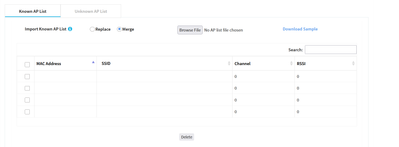

Bug: Neighbor AP Known List not Populating
I have several WAX620, WAX610, and WAX610Y's across two different sites, all running in local management mode.  Since version 10.8.6.3, if I look under Configuration -> Security -> Neighbor AP -> Known AP, all I see is blank rows.  This behavior has continued in the current 10.8.7.1.  Below is an example image.  The screen looks the same across all devices
If I instead go to Monitoring -> Neighbor APs -> Known APs I can see the associated MAC Address, SSID, Channel, and RSSI (as expected) to confirm that the networks are being recognized.  In addition, as far as I can tell the functionality of Neighbor AP still appears to works.  It just seems to be an issue displaying.
I tried removing the Known APs and re-adding them after upgrading firmware, but they behavior persists.
I rolled back two of the APs to 10.7.5.3 and confirmed that the values I'd expect to see under Configuration -> Security -> Neighbor AP -> Known AP are there.  So something in the 10.8.6.3 release is preventing the values from displaying.

    Thanks for pointing out this issue. We are able to reproduce this issue in our testbeds. We will address this in upcoming releases.
