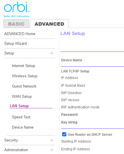

- CrimpOnApr 26, 2024Guru - Experienced User
Yann72 wrote:
No. The default settings of the ORBI RBR-750 is to act as a DHCP server, which is NOT most users want (especially in Europe where we all already have a DHCP server inside our ISP box).
To solve the issue, the ORBI RBR-750 must be reconfigured as an access point, which is not possible from the ORBI app.This is not entirely correct. On the Orbi LAN setup page, operating as a DHCP server can be enabled or disabled:
