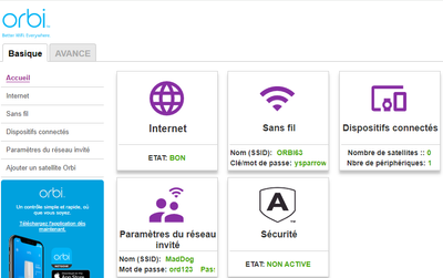

No. The default settings of the ORBI RBR-750 is to act as a DHCP server, which is NOT most users want (especially in Europe where we all already have a DHCP server inside our ISP box).
To solve the issue, the ORBI RBR-750 must be reconfigured as an access point, which is not possible from the ORBI app.
The only way to reconfigure the ORBI RBR-750 as an access point is to connect to http://orbilogin.com/ from a computer (via Wifi, NOT via a linked Ethernet connection).
But the http://orbilogin.com/ page only opens if the web browser is configured in English only. All citizens from countries where English isn't the native language, must reconfigure their web browser to access this page.
- CrimpOnApr 26, 2024Guru - Experienced User
Yes, it is unfortunate the Netgear did not include the option to set the 'mode' of the router ("router"/"access point") in the Orbi 'app'. This can only be done in the Orbi web interface.
In the upper right of the screen, there is a drop down menu to choose the language for the web interface. The choices include 24 languages.
- Yann72Apr 26, 2024Aspirant
"In the upper right of the screen, there is a drop down menu to choose the language for the web interface. The choices include 24 languages."
Yes. But if you chose something else than English (for instance French, as it is configured by default when you install the Orbi in France), then the page leads to a "non supported language" error message, then a 404 HTTP error, and you can never access the administration interface. The language must be forced to 'English' (and not 'Auto' which leads to the same error if your browser is configured with another default language) to be sure you access the page from any localized browser.- CrimpOnApr 26, 2024Guru - Experienced User
et Voila
what firmware version is running on the router?
This is v7.2.6.31
