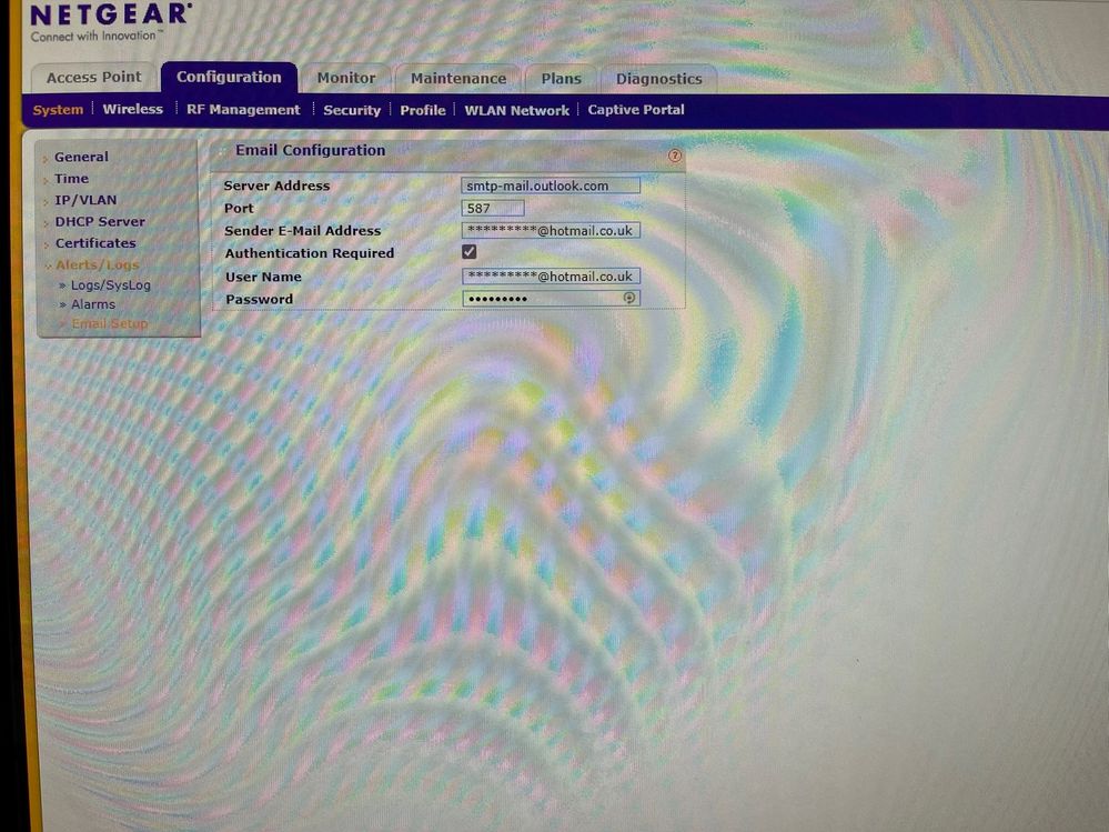

      • DeNeil's avatar
        DeNeil
        Hi
        The Model is WC7500
        The firmware is: Firmware version: 6.5.3.9
        I have blanked out the email address for security.
        After hitting apply, everything looks ok - I then navigate away from the page and come back to it and it has lost my entries.
        The menu is under Configuration, System, Alerts/Logs, Email Setup
        I have enabled syslog under  Configuration, System, Alerts/Logs, Logs/Syslog
        I have set parameters for severity and to send E-mail to my email address under  Configuration, System, Alerts/Logs, Alarms.
        Thanks
